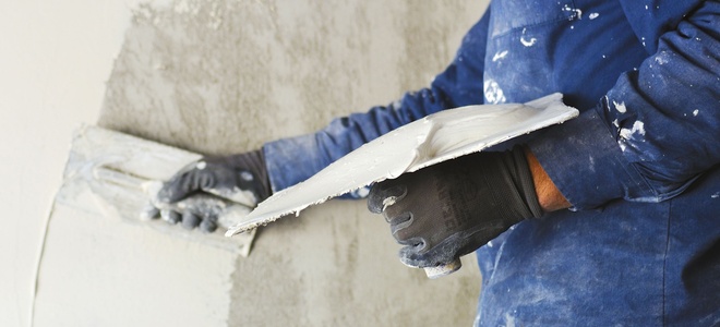

Since we are skimming a whole wall, it is best to start from the top corner and work across and down. Your practice runs should have yielded a joint compound of a great texture. With your knife, apply the mix and scrape the excess off. Continue doing this same technique over the entire wall. Make sure that you work in a small area. When you work in a large area it is harder to ensure the skim coat will be even. While you are applying the skim coat it is essential that you have good lighting. Because the coat of the joint compound is so thin, you must be able to see all of the small differences to get a smooth finish.
