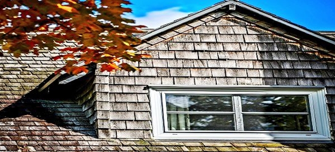

Homeowners and building contractors often choose cedar siding for house exteriors because of its durability, beauty, and elegance as well as its natural resistance to decay and insects. Natural cedar siding varies in color between a honey brown to a deep cinnamon red. Left in its natural state, its color will change to silver or grey as it ages. For this reason, many homeowners choose to spruce up their cedar siding using fresh paints and stains.

The condition of the cedar siding is the first factor you should consider before choosing a coating system. Paint provides a protective layer across the surface of the wood without penetrating its pores, which makes it an ideal coating for hiding discoloration and imperfections in wood. Although old, cracked, weathered, and discolored wood will require extensive labor to restore no matter what type of finish you choose, paint will more effectively hide material flaws, whereas stain may exaggerate them.
