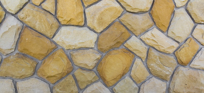

Stone is often used for fireplaces, hearths, and accent walls in the home. Their maintenance, care, and repair vary from traditional materials. This will guide you on what to do.

This guide on stone maintenance, care, and repair will get you back on track, but there are some measures you can take make it easier in the future. Stone fireplaces will be easier to clean if you apply a finish of penetrating sealer which contains tung oil. This is moisture resistant and forms a coating tough enough to wash with soap and water.
