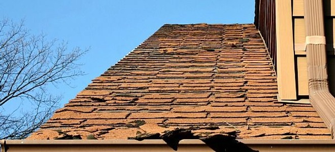

Get on the Roof
Walk the roof to check and repair any loose shingles or replace missing ones. If you have a flat roof, check for cracks and seal them with roofing fabric tape and roofing cement. If there are cracks to seal, wait for the roofing cement to cure, and coat the whole roof with silver or black roofing sealer while it is still cool out. Also, check the chimney cap to see if it is clear and sound. While you have your ladders out, clean all the gutters out. You may need a trowel for this if leaves and sticks are sticking to the gutters. Pull out everything in the gutter. Take a garden hose up to the roof and secure it to the ladder. An empty hose is much easier to carry than a charged line. Once you have the hose nozzle well secured to your ladder, turn the water on and hose out the gutter. Also put the hose nozzle in the downspout and turn it on full to wash out any leaves, sticks, or bird nesting material. While the ladders are still out, replace any burned out spotlights or outside light bulbs. Next, check the entire exterior to assess any painting needs and if necessary get together all your painting tools.
