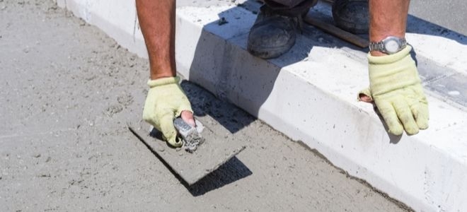

hand leveling poured concrete
For a sunken concrete surface that can’t be repaired with a topcoat fix or foundational reinforcement, a complete replacement is your only option. This involves the same foundational steps of hauling in suitable materials and compacting them, but requires many additional steps as well. You will need to break up the original concrete and remove it from the space. This can be done with a jack hammer or heavy equipment. You may also need to haul away inferior sub grade. At that point, add new materials and compact. Then build the frames for the concrete and pour. Finish and seal your concrete to complete the job.
