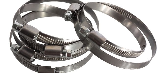

Clamp a rubber hose onto a fitting, such as those used on garbage disposals, by slipping the clamp strap over the hose. Slip the hose over the open end of the pit fitting and insert the fitting into the hose. Slide the clamp down the hose until it is over the fitting, then, tighten the clamp with a screwdriver.
