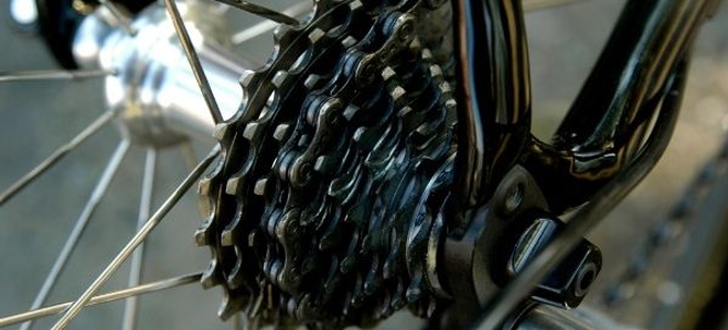

A bicycle is only as strong as the bicycle chain. Without the bicycle chain running in optimal condition the bike is useless or difficult to ride. You can save yourself a lot of physical effort if you clean your chains correctly. Here are a few tips that can help with your cleaning process:

Don't forget about cleaning both the front cog and the rear cassette. Since they are the support housing for the chain, they also get clogged with debris and gunky lubricant. Forgetting to clean the cog and cassette, then pushing the clean chain through them can feel uncomfortable and frustrating.
