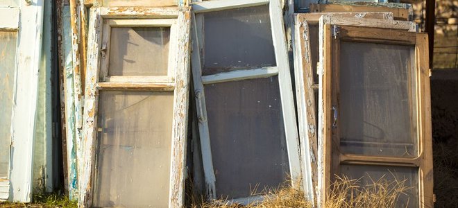

3. Window Repair for Rotted Wood
rotting wood on a white window
If part of your window frame or window sill has rotted, you might not need to replace the entire thing. Instead, you can conduct a window repair. If most of the wood is still good, just chisel out the rotted area. Then soak the area with liquid epoxy consolidant. After five minutes soak again. Keep doing so until the wood is flooded with the epoxy.
Now mix some epoxy filler and put it in the hole with a putty knife. Make sure it fills completely. Once the filler dries, you can sand it down to the level of the rest of the wood. You should paint or seal the wood within three days.
