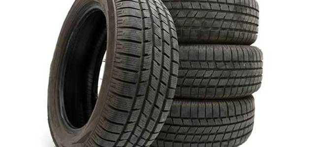

Tires
Proper tires are vital for vehicle comfort, handling and safety. Tires are made for all vehicles at the consumer level, primarily passenger cars, minivans, performance automobiles, light trucks and SUVs. In addition, a wide selection of tires are made for motorcycles and scooters, competition cars and trucks, ATVs and all manner of commercial vehicles. Depending on their application, tires differ in terms of size, design, construction and performance characteristics.
