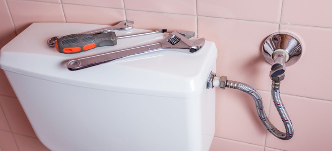

Tools on a toilet tank against a pink tiled wall
