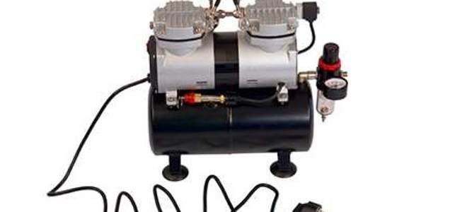

About Air Compressors
An air compressor is the central power source and your major investment. Air compressors are available in horsepowers of 3/4 to 5, or even larger, with a variety of tank sizes up to 80 gallons. The capacity and the frequency and duration of use will determine the horsepower and tank size you'll need for your own projects. A 2hp or smaller will be adequate for most tanks around the house. Typically these size units will have tanks from 7 1/2 to 20 gallons. Choose an air compressor for quality and protective features. Certification by ASME-the American Society of Mechanical Engineers-is the only guarantee of quality in workmanship and materials, and is a main measure of quality. The ASME label will appear on the tank. All compressors do not have ASME certification. Only ASME certified compressors can be sold in some states.
Other features that will be found in a quality compressor include:
An ASME certified safety relief valve which will allow air to escape automatically if pressure in the tank should ever exceed the maximum. This valve will have a pull ring attached to it to allow you to check the valve to make certain the valve is not clogged or corroded.
An oil level sight glass, a tank pressure gauge and, of course, a pressure regulator and gauge are important, as each tool and job has a specific pressure requirement. The tank maintains air at maximum pressure from 100 to 125 pounds of pressure per square inch. PSI is the force of the pressurized air delivered to the tool. Projects and tools have both pressure and volume requirements. Volume is measured in cubic feet per minute (CFM) or standard cubic feet per minute (SCFM). When selecting and using a compressor, it is the relationship of CFM (volume of air) and PSI (force or pressure of air) that is important.
A manual thermal overload button is important in case of overloads or if the motor overheats. If the motor overheats, it automatically shuts off. This protective control button must be pushed for the compressor to run once the motor has cooled down, preventing a sudden and unexpected restart. The best air intake filtration system will be enclosed and mounted on the side of the compressor. This does more to protect the filtering foam, inside the housing, keeping the compressor cleaner, longer.
A belt guard is indispensable protection and the compressor should never be turned on without the guard in place.
A hose rack is desirable for convenience and for protecting the air hose when not in use.
One other feature, most desirable to the do it yourselfer, is a toll free number to call should a question or problem arise.
