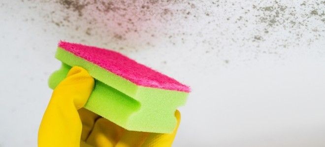

a gloved hand cleaning mold from a white ceiling with a pink and green sponge

Clean the Surfaces
If the material is non-porous or semi-porous, you may be able to clean them. Examples of non-porous or semi-porous items include glass, concrete, hard plastic, metal, and solid wood. Cleaning the item should start with a HEPA vacuum to remove as much contamination as possible. The standard household vacuum or shop vac will not work unless it has a high-quality HEPA filter installed on it.
If you can't get a HEPA vacuum, wipe the item off with a damp cloth. Rinse the cloth often and dispose of it when you are finished. After you have removed as much of the mold as possible using the vacuum or cloth, it is time to scrub. All contaminated surfaces should be scrubbed with a stiff brush, hot water, and a non-ammonia soap or commercial cleaner. Use a wet/dry vacuum or sponge to collect any excess cleaning water. Rinse the item with clean water and dry everything as thoroughly and as quickly as possible.
Disinfect
You may want to follow up by disinfecting the surfaces to kill any remaining mold. Use a mixture of one-half cup bleach per one gallon of water and apply it to any surfaces where mold was growing. Allow the bleach water to air dry on the surface, but use a wet/dry vacuum or sponge to collect any run-off.
