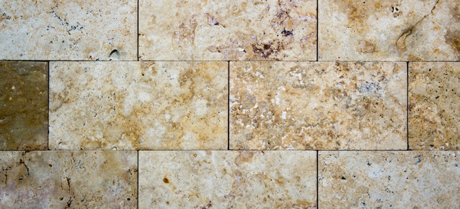

Travertine tiles are natural stone tiles that while are incredibly beautiful, are also very high maintenance. In fact, many homeowners say they have a love/hate relationship with their travertine shower. They love the beauty,  but they spend a lot of time making sure that it is maintained correctly.
When it is maintained correctly, travertine can last for over 30 years and still retain its incredible shine and beauty.
