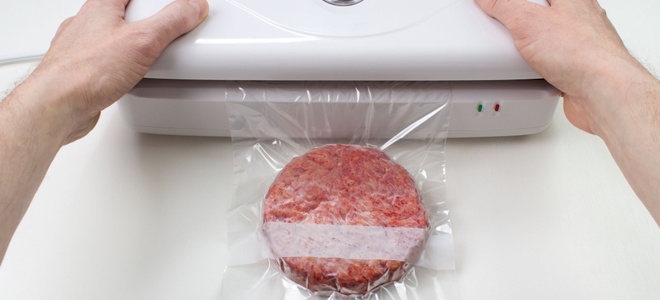

Most users who experience problems with their food vacuum sealers can fix the problems themselves with relatively minor adjustments. Mainly, the food vacuum sealer has only three general parts and it is easy to distinguish which part is malfunctioning. The suction system of the appliance pulls air from the storage bag. Then the food travels into the sealing chamber and the sealing system adheres the bag to itself causing the vapor lock around the food. If the problem can be isolated to which step in the process something is malfunctioning, the chances of fixing the issue are very high.

If there seems to be no trouble with the operation of the appliance or if success is spotty, check to make sure there are no pinpoint holes in either the plastic roll or the sealing bags. Even a small hole can cause the vacuum sealer to be trying to create a vacuum on one side while air is seeping in on the other.
