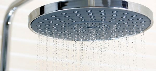

If the electric shower cuts off after about a minute of running normally, the problem might not be in the electrical system. Try removing the showerhead and tip it upside down over a bowl. You should find some limescale tipping out of the showerhead.
Buy some limescale remover and place the shower head in it, holes down. Doing so will remove the limescale that’s clogging the showerhead. Remove the showerhead and wash through with cold water to take out all the debris. Screw the showerhead back on and try the shower again. With no more clogging the shower should run normally. What has happened is that, as the water stays too long in the heater, the cut off kicks in and stops the shower.
