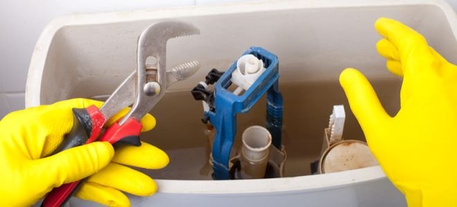

gloved hands fixing open toilet tank with plumbing wrench
Plumbing problems are stressful, especially when they're happening to your toilet. After all, the toilet may just be the most essential piece of plumbing in your entire house! There are a number of things that can go wrong with your toilet and it's always the wrong time for any of those things to happen. Here's how to handle the most common issues.
