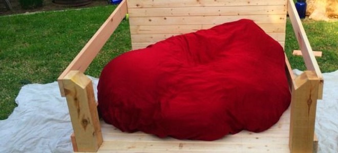

Beanbag chairs are great to sit on. They conform to your body and give just the right support where you need it. But sometimes they’re just a little too casual, a little too juvenile. We’ve had one for quite a while and I decided it was time to elevate it. Literally.
I built a simple bench to get the beanbag chair off the ground and surround it with a bit more adult respectability. It’s the perfect place to kick back, read a book, or take a quick nap without looking like you still have homework to do.
Step 1 - Plan for the Bag, and the Space
I knew I wanted a basic platform and back of the proper size to support the beanbag, but I also needed to take into account the space it would be filling. Normally, beanbag chairs are easy to toss around a room and conform to most any area you throw it in. This piece, though, was much more substantial furniture.
I settled on a 3-foot by 3-foot interior space. 4x4 posts would make up the legs, widening the stance from there. Then there was the exterior framework holding it together, so the entire footprint was about 3 feet, 9 inches square.

Now the bench looked like an inviting place to sit. Except that it didn’t have a seat. Or a back. So it was time to fire up the miter saw again and start cutting the 1x3 slats.
The first two slats were a different length than the others to accommodate for the front legs. In an effort to create an even cleaner look for the piece, I hand cut notches on the first slat so it wrapped around the front legs. The second slat fit exactly between the legs.
Turn an Ordinary Beanbag Chair Into a Reading Bench, Nico Rosso
From there on, the slats were all the same length across the entire seat of the bench, so I set up a stop on one side of the miter saw at that same distance and started cutting slat after slat.
The back slats were slightly shorter because they only rested on the upright posts, so I adjusted the stop block before cutting those.
Everything was dry fitted, to make sure the math was correct and there wasn’t too big a gap between the seat and back. Once everything was in place, it was time to make it final.

Step 5 - Sand and Finish
Running two orbital sanders, we knocked down the fuzz on the slats. The other wood had some hard edges that were eased by the sanders as well. The remaining air in the compressor was used to blow the saw dust away, leaving a clean surface ready for relaxation.
Placing the beanbag on the bench suddenly gave it an almost stately appearance. The wood might get painted at some point, but even bare like this, the piece has a nice casual feel, which will fit nicely in a den.
