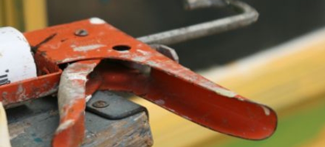

A smooth rod caulk gun, loaded with a cylinder and ready to use.

Caulk Gun
Now you know all about the wide variety of caulk types, but a caulk gun is similarly important when considering a DIY project, as it is the best, easiest tool for sealant application. Caulk guns come in different kinds as well, but unlike the sealant itself, there are only three.
Ratchet guns are less expensive, but are more difficult to use. These stop caulk flow by requiring that the user turn the piston so the ratchet disengages.
Smooth rod guns are more expensive, but easier to use. With a smooth rod gun, the user simply disengages a quick-release thumb plate to stop the flow of caulk. Drip-free smooth rod caulking guns allow the piston to back up slightly after each squeeze so the user does not have to turn the piston or depress a lever to stop the flow of caulk. Some models use an automatic vacuum action to draw any unused caulk back into the nose of the tube.
Power guns that operate with a rechargeable battery pack are obviously the most expensive variety, but they are becoming popular with pros and serious DIY enthusiasts for their ease of use.
