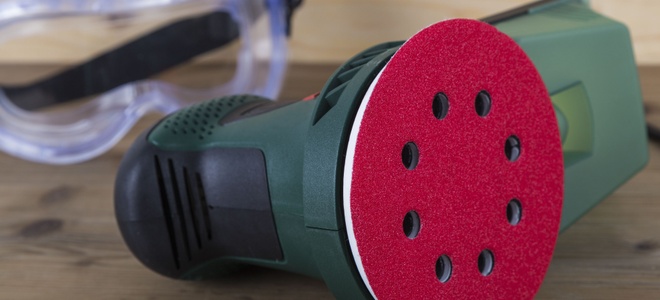

random orbit sander
Random Orbit Sander
  • Uses a round disc of sandpaper to sand in both a circular and back-and-forth motion, which reduces swirl marks.
  • Common sizes are 5” and 6”, but smaller and larger sizes are available.
  • Sands in all directions, both against and with the grain.
  • One of the biggest differences in these sanders is the grip style a manufacturer may use. Some have grips at the front of the sander, while others have handlebars that can be attached at either side of the sander.
  • Another important feature is variable speed for slower, delicate work or faster, heavy work.
  • Most use a dust bag to collect sanding dust
