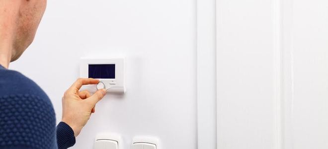

Zoning System
Having only one thermostat in a two-story home is another culprit for uneven temperature swings. It takes more time to heat two stories, so the thermostat on the first floor will sometimes shut off before the entire house is properly cooled or heated. Remedy this problem by adding a second thermostat to the upper floor. This will allow the system to remain on until all areas of the home are at the same temperature. You may need to add more than two thermostats, depending on the size and layout of your home.
