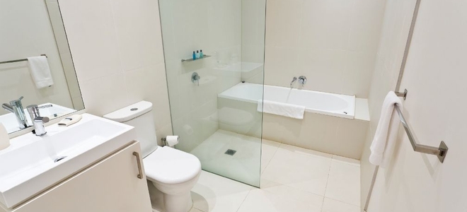

You should have ample space inside your universal shower for someone to get around with a wheelchair or a walker. If your bathroom is small, you may want to consider making it into a space that can be wet in its entirety. This can be done by adding an extra drain in the floor and sloping the floor toward the drain. The bathroom would have to be made into one open space without walls that separate the shower, sink, and toilet.

Having walls that are angled or curved helps to keep the water in the shower and create privacy for showers with no door.
No Curb Entry
To create easy access for people in a wheelchair or with a walker, there should be no curb into the shower. However, there are compressible plastic strips that can be placed on the floor at the shower's entry. They can be easily rolled over with a wheelchair or a walker. These strips don't create a hazard as far as tripping is concerned and they help to hold the water in the shower.
