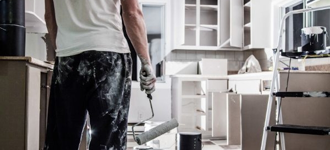

Cabinet painting is a little more work than wall painting but if you're are a DIYer, it should be no problem at all. The first thing you want to do is remove the cabinet doors and drawer fronts. Take a bit of masking tape and mark each door and where it goes with corresponding letters or numbers. This way, you won’t forget which door goes where once the project is complete.
Set up an area that won’t be needed for a couple of days. The hardest part is waiting for the paint to dry and you will need a place for everything to sit undisturbed while it does. Clean each door with TSP or a good de-greaser — you will be amazed at how much grit and grease has accumulated over the years.
Once the doors are dry from their cleaning, sand them with a fine grit sandpaper. They just need a little roughening up to help the primer and paint adhere. A 100 or 120 grit paper should be good enough. If there are any nicks or dents in the doors, now would be a good time to fill them with putty.
Vacuum off the residue and wipe down each door with a tack cloth. You are now ready to prime. Don’t skip priming; it helps even out the surface and makes it easier for the paint to apply. When priming, brush first against the grain of the wood, and then with the grain. This helps the primer get into every crevice and will give a much smoother surface. While you're waiting for the doors to dry, you can follow the same procedure for the cabinet boxes.
After the primer is thoroughly dry, give it one more roughening up with 220 grit sandpaper. Vacuum and use the tack cloth again. You are now ready to paint with the color of your choice. It's best to apply two thin coats and allow to dry at least two hours after each coat. If you're adventurous, you could use a sprayer, but I always like the control a brush gives.
