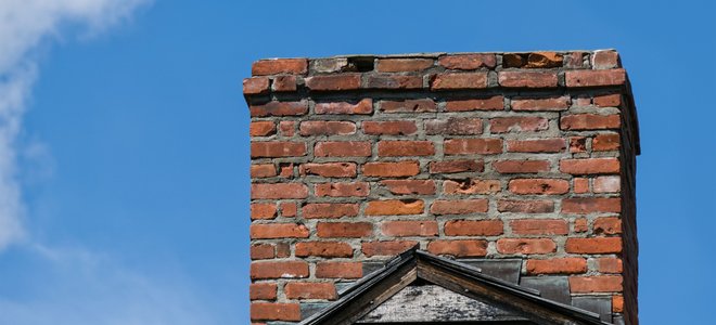

Water Damage and Your Masonry Chimney
A brick chimney in front of a blue sky.
