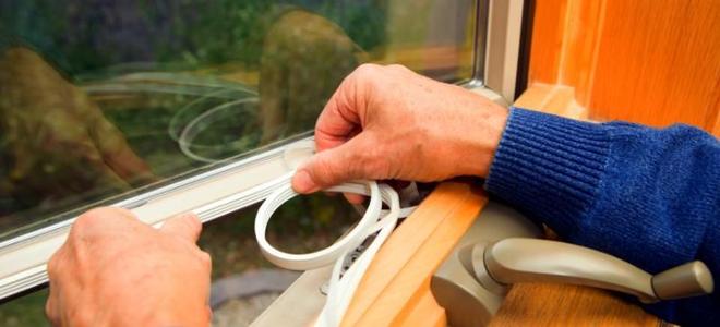

Install Weather-Stripping
The insulation around windows and doors is called weather-stripping. Weather-stripping is designed to stop the flow of air around doors and through window sashes and frames when they are closed. Simple products, which make for easy do-it-yourself projects, such as door shoes can be installed. This form of weather-stripping contains a rubber gasket that can be attached to the bottom of doors to seal it to the threshold. There is a product called jamb-up - applied around the door jamb - that contains a rubber bulb which compresses to the door to seal it upon closing. Gaskets are used to seal windows. The simplest is a rolled insulating material with an adhesive backing, which is applied by pressing it around the window. Windows frames that are leaking should be caulked with a high quality latex caulking, which can be painted to match the color of the exterior walls.
