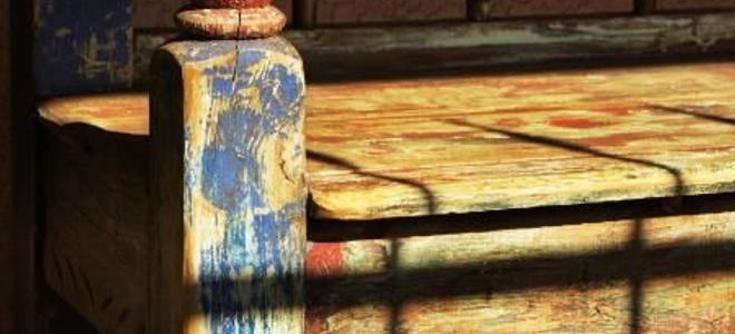

Stripping Furniture
A bed frame with peeling paint.
