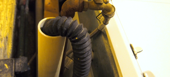

washing machine hose placed to drain into a standpipe
During construction or when you install a washing machine in a new location, you will need to install a standpipe so that the washing machine has proper drainage.
For existing plumbing, you will cut into the vertical piping and add the standpipe to the line. For initial plumbing, you will need to install all of the pieces from the drain to the machine. Either way, the standpipe height should fall between 30 and 48 inches from the floor.
You will need to confirm building codes in your area, but most outline that the trap is at least 12 inches off the floor and the standpipe is a minimum of 18 inches above that. Around 39 inches is the average, and if your space allows it, the ideal height for your standpipe.
