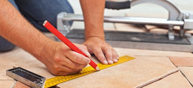

Dress Rehearsal
If you don't want a headache later from some unexpected issue, planning how your tile is going to fit and look is a step that shouldn't be skipped. This step is called "dry fitting." To dry fit your bathroom floor, lay the tile on the floor in whatever pattern you want and then look for obstacles, such as pipes or corners. Being able to measure and precut some or all of the tile during this dry fit will save you a lot of time when it comes to the actual gluing down of the tiles.
When planning around your shower or tub, use full tiles in this area, as it will look better than having half tiles here. Planning it with the full tile along the shower means that the tiles cut into fractions will be on the opposite wall—one that is usually a lot less noticed.
