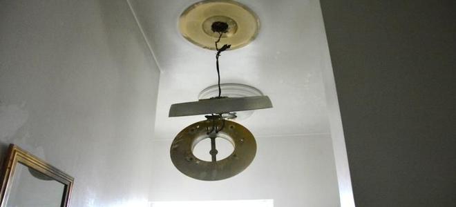

Investigation
First I had to remove the existing heater. This was fairly simple, involving only a flathead screwdriver. The thing was built in stages, so I removed the cover, then the heating element and shield and finally the base, which was attached to an electrical box in the ceiling. I capped off the wires and now I had a 4 inch by 4 inch hole in the ceiling, filled up by the electrical and giving no clues as to where the framing might be. Time to cut an exploratory hole and find out what was up in my inaccessible attic.
