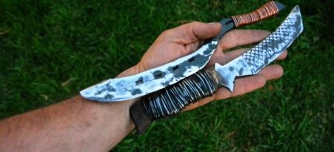

Slice an apple, open the mail, or cut yourself free when you’re wrapped in a rope being dragged by a wild horse, you never know when a good blade will come in handy. As a man who might find himself in any one of those situations, and as an avid DIYer, I make my own knives to suit my needs. “Never go anywhere without a knife.” That’s been a rule long before it was popularized on a hit TV show. In fact, the knife is one of the most ancient and fundamental of tools, second only to the hammer in age.
Choosing the Metal and the Fire
I like to start with repurposed raw materials—old horseshoes, worn out farrier’s rasps, dulled auger bits—whatever lengths of good and interesting steel I can get my hands on.
Horseshoes will get hot enough in my homemade coal forge, revamped from a wok and a blow-dryer. For more advanced steel, like the rasp and the auger bit, you need a gas fired forge unless you want to constantly feed and stoke the coals.

Turn to your bench-grinder when the metal’s cool enough to work barehanded. Grind off any burs and refine the shape. Use your belt sander to really shine it up and go back to the grinder to put an edge on it.
If you’re going to cover the handle, I like to wrap it with steel or copper wire, over and over again, until you have a good, comfortable and well balanced grip. Sometimes I put the wire grip back in the forge and heat it up and hammer it a bit, sometimes I don’t.
That’s your knife. You could hammer out the groove and nail holes from the horseshoe, or beat the file points off the rasp, but I like to leave behind the marks that remind you what your knife used to be. This is a hand forged tool and there’s no reason to try and hide that.
