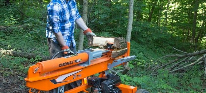

The three basic things that you need to assess about the logs you will be splitting are:
  • What type of wood will you be splitting? What type of tree did it come from? Since all wood consists of varying levels of hardness, determining how hard or soft the wood is will determine the force (tonnage) you need to split it. For example, a typical Oak tree log is rated as requiring approximately 1350 lbs. of force to split it, based solely on its level of hardness.
  • How big are the logs you will be splitting? Measured in diameter, the bigger the log is across, the more powerful the splitter will need to be to split it – obviously. Splitting that same Oak tree log, with a diameter of 24 to 36 inches, will require a 35-ton log splitter to ensure you get the job done right.
  • How green or seasoned are the logs? Ultimately, this will go a long way in determining the amount of force that will be required to split them. Freshly fallen logs are likely to be greener, or wetter, and require a higher tonnage than some that have dried out over time. In some cases, really green wood may even necessitate an additional 10 tons of force to split.
log splitter force
