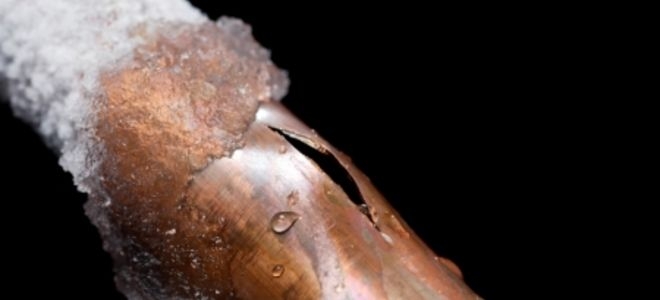

A copper pipe that's burst open from the cold weather.

Exterior Pipes
Take a look at all of the exterior pipes and remove any garden hoses. Fully drain the hoses before winding them up and storing them for the winter. Then locate the shut-off valves for the faucets. (The shut-off valves are typically indoors.) Once the valves are closed, turn on the outdoor faucets and drain the excess water. Once all of the water has been removed, the exterior pipes should be fine over the winter. If you are concerned about some exposed pipes, you can insulate them for even better protection.
