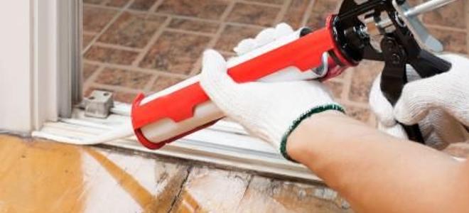

Step 1 - Stick the tip of the caulking cartridge into the corner you wish to seal and pull the caulking gun handle/trigger slightly until you get just a bit of caulk to come out. Keep the tip moving, as you want an even amount released, no more than about 1/4 inch thick. Start at the top of a frame and work your way down, or work right to left.
Caulking a door frame.
