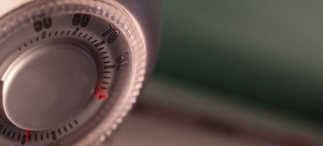

Like many do-it-yourselfers, my house was built around the time of the dinosaurs and much of the equipment was so antiquated that replacement was a matter of necessity. I noticed that my thermostat, a non-digital dial type that I am pretty sure was installed by Thomas Edison, wasn't quite working up to snuff.
It was time to replace it, and while I was no expert at electrical wiring, I was determined and dedicated. As the temperatures begin to fluctuate and winter turns to spring you may be thinking of replacing an old thermostat too.

Most thermostats have a wall plate that can be removed usually by sliding it up. This exposes the screws. Remove these and take the unit off the wall. Be careful when removing the thermostat from the wall. The wires are still connected and that last thing you want to do is accidentally rip them out.
